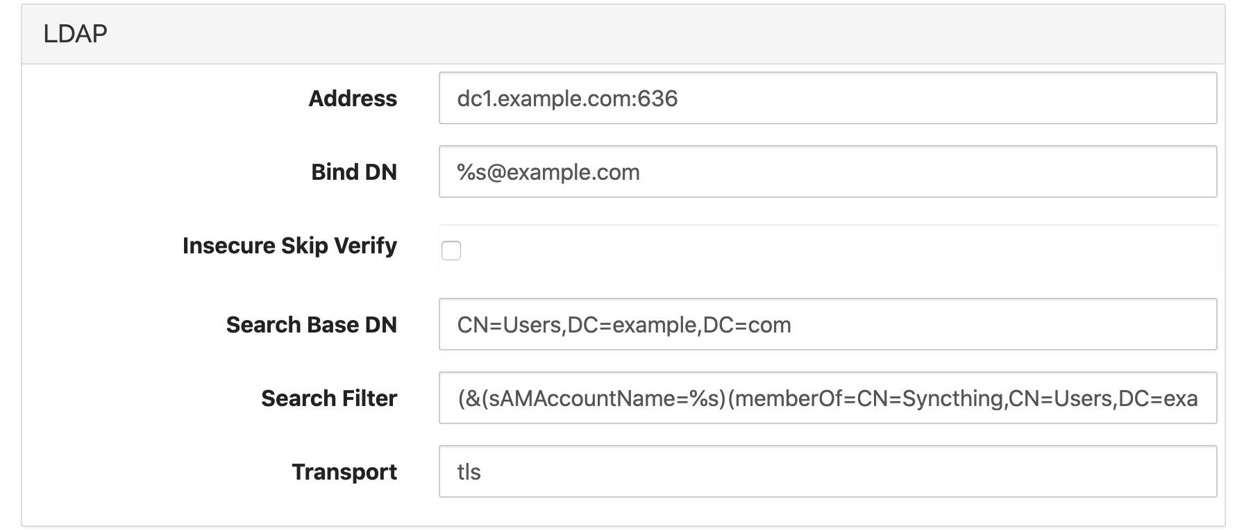

A simple setup might look like this:

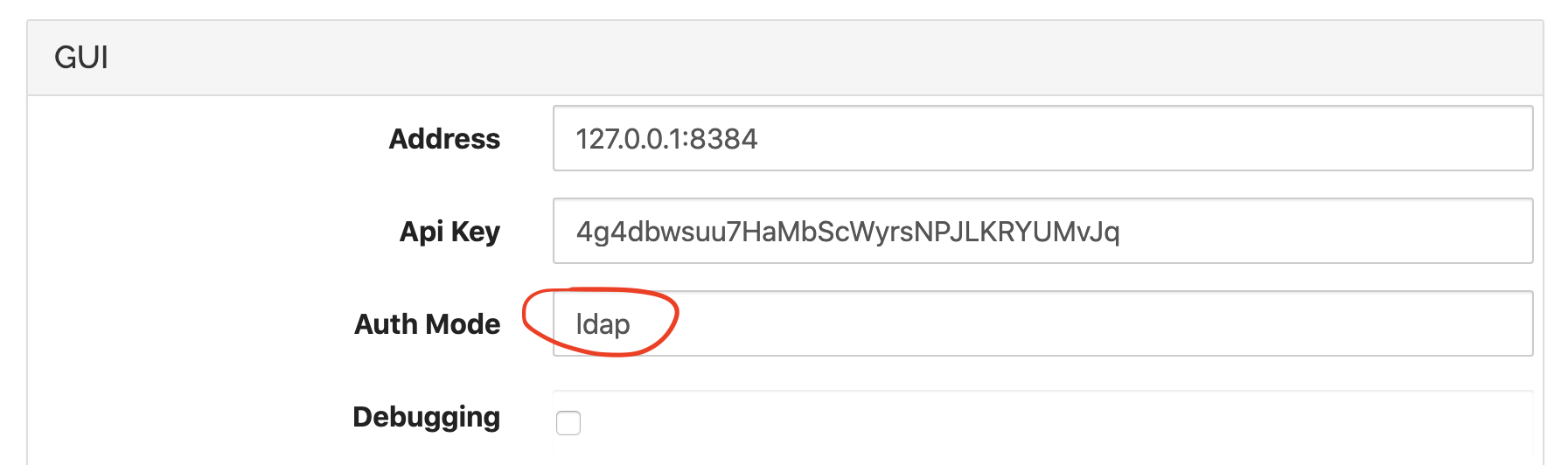

Once these settings are correct, LDAP authentication must be enabled by
setting the authentication mode to ldap in the advanced GUI
configuration:

Line breaks for clarity only. We enter this as one long string. For example, like this:
